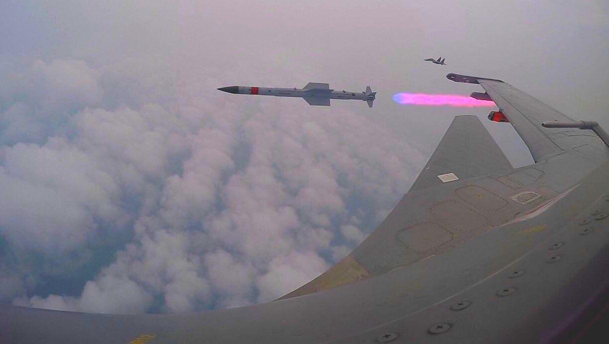

Astra has a range of 110 km and has been integrated with Sukhoi-30MKI. It is set to be integrated with Tejas, MiG-29 and Mirage 2000 fighters of the IAF.
I've read the report too, but that query was to address @randomradio's assertion that M-2000's design isn't optimized for BVRs longer than MICA(3.1m length). That's why I wanted confirmation of @Picdelamirand-oil regarding the above.![]()
IAF To Arm LCA Tejas With Indigenous Air-To-Air Missile Astra As It Formally Integrates It With Sukhoi Su-30 MKI
The Indian Air Force (IAF) has formally announced the induction of the indigenously built Beyond Visual Range (BVR) air-to-air missile Astra, Defence Aviation Post reportsswarajyamag.com
