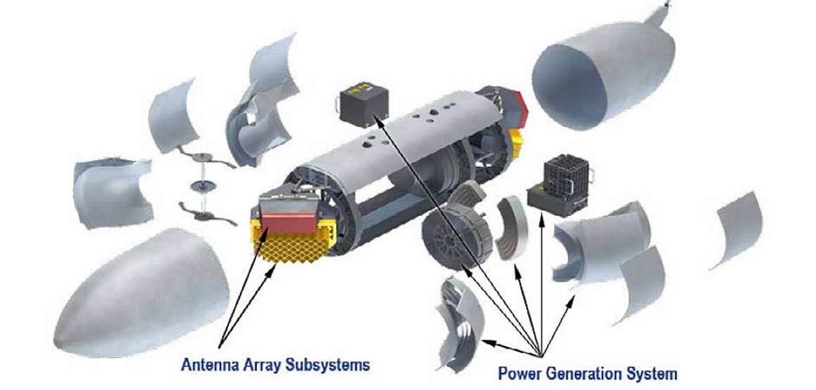

Yeah, but that's spread across multiple arrays. There's one set in the front, one set in the back and at least one more on the side, if any. So all that cooling is spread across 4 arrays.
Here's an example:
This one has 4 arrays.
And the array size is small, so there's not a lot of TRMs on each one. So there's not a lot of power coming out of each array.
Here's an example:

Just like to add more, as I have added this image some replies back
We have already developed 25-40w GaN MMIC, so it doesnt need to be big as people think.

The developers themselves stated it's based on the Siva pod.
And yeah, that's a pretty small pod. The requirement is for the MKI to be maneuverable while carrying 2 of them, which wasn't possible with the SAP-518.
Anyway, I'm not disputing the power rating of the cooling system, what I'm saying is the cooling system isn't powering a single array, but at least 4 different arrays. And not just the arrays, it has to cool the power generation system and RWR too.
You are confusing standoff jammers with SPJ.
Now this is the ALQ-99 for the Growler. Look at the size difference.
Just so you can imagine the scale, the ASPJ is about twice as big as the person's face. Or a little bit bigger than a large watermelon. Its peak power is 6.8-10.8 kW depending on the version. So this is the type of jammer that requires a lot of power, and has an antenna large enough to output that kinda power. Otoh, SPJs do not work with power, they work with waveforms and very low power.
Another fun fact: the NGJ's cooling capacity is 56 kW, while the RAT provides 60 kVA of electricity.
And here's both HBJ and Siva pod in the same image. The HBJ is just an elongated Siva pod.
It's not as large as you think it is. And it always came with GaN right from the beginning.

How many TRMs are you expecting such a small pod to carry?
Indeed, its going to be dedicated EW platform, unlike MKI.
That's where you need power.
This image is from 2017, and now they have even stopped calling it HBJ after 2021. Because they have already extended it to somepart of C-band and upto full Ku-band (WB).
That only serves to work against your argument. If the jammers goes from C band to Ku band, then it's carrying multiple arrays. You can make X band work from 6-10 GHz, but you need an array or 2 for beyond 10 GHz, up to 18. So that small space will have to carry multiple arrays. Even in the sides if necessary.
So the pod is not only carrying multiple arrays, but also on multiple sides, and that 3.5 kW is distributed to the entire pod, not just the arrays.
