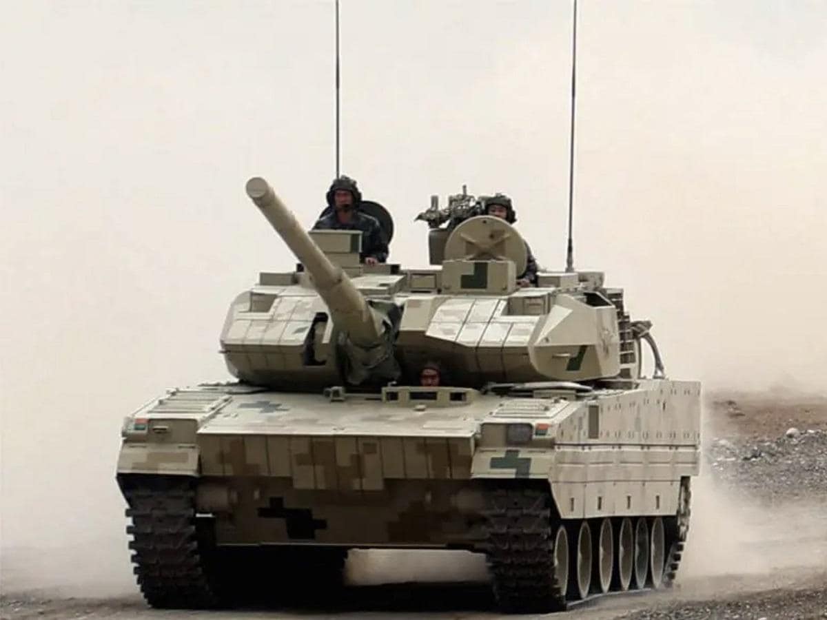

It's meant to support infantry via sensors, mobility and firepower. But yeah, the Type 15 will kill it.
Chinese infantry with RPG type weapons will kill it. A bmp2 will kill it.
They will add ERA and add-on armour, perhaps even APS. The main threat will be a tank gun from the front.
In any case, the range of the gun will be high enough to defeat smaller threats with just firepower. A 30mm cannon from over 2Km won't be as effective. RPGs don't have range, getting close to tanks isn't easy. ATGMs will be the next big threat to it after tanks.
