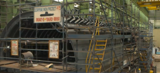

Found some pics of the Kalvari class diesel-electric submarines during various phases of their construction at the Mazagon Docks Ltd. The construction of the submarines began at MDL's dry docks. Sections of the internal pressure hull was built first.
The submarines were constructed using modular construction method. Which means the submarines were built in sections and then assembled.
