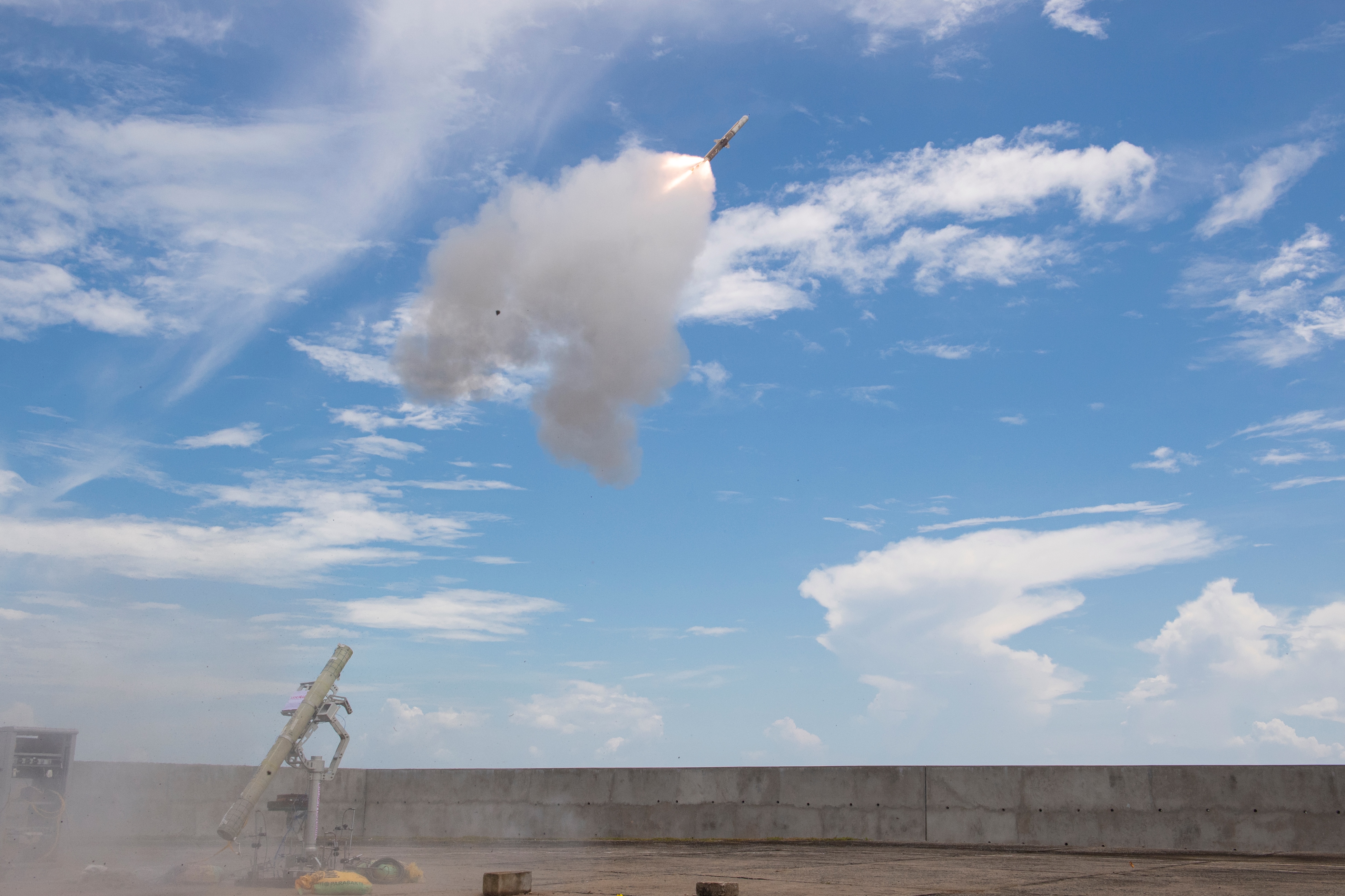

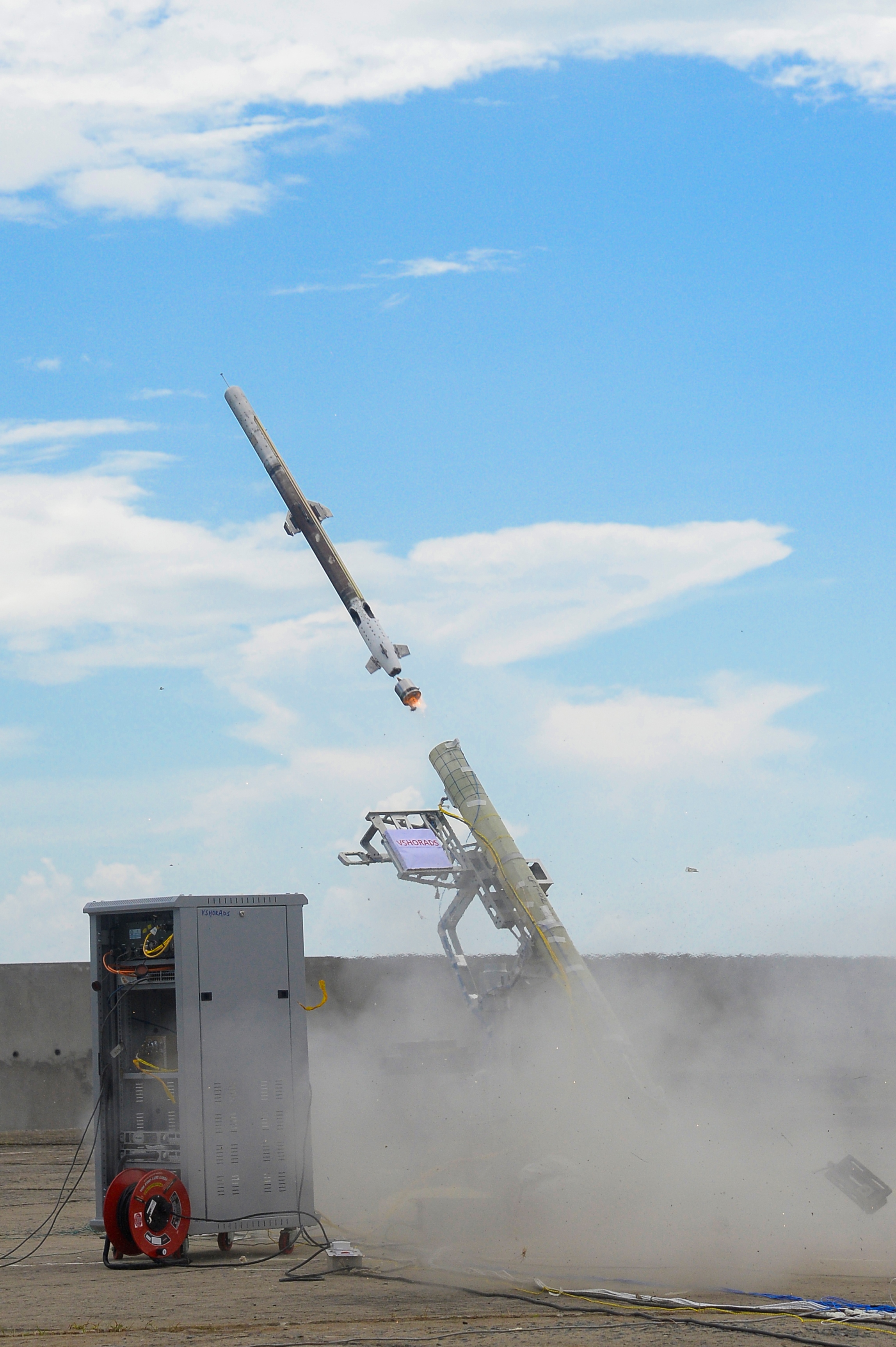

No figures out yet. But just from the size of this thing in figure compared to the extension switch on the ground. It doesn't seem MANPAD to me.

It seems to be a rbs-70 ng and mistral equivalent.

The mpdms would be different to this. Hope they develop a crotale NG equivalent too in the future.

There are systems weighing upto 20 kg with the missile and CLU unit. If it's less than say 20-25 kg combined.

From the looks of it, its outer ranges is in excess of 6 km (from the launch video it seemed to go 7 km with ease). The AMDL is being jointly developed by Green Robotics and BEL, and is unique to all MANPADS. It means that the missile can be fired through a network. Which means not only the launcher can be remote from the operator but one can have a network of remote stations which can be triggered by a surveillance platform.
It features a dual band IR seeker (which is supposed to be uncooled) and be guided by a multi-spectral optronics unit (beyond network intelligence). from the looks of it, it hasn't copied any known MANPAD. Its tail fins seem to be maneuverable, while its frontal fins, more mid bodied, are for stabilization. This is the reverse of most MANPADS. It looks bulkier than even Mistral. Which means its weight will be closer to 20 kg. If not more.
It seems to carry substantial more fuel as also have a large enough guidance and warhead section. It's supposed to be a dual-thrust solid propellant rocket engine. The aft section will burn faster and provide it with adequate thrust to reach a high speed. The next section will burn slower, providing it acceleration but also much greater range. It's also supposed to have a Miniaturised reaction control system to aid maneuverability.
It remains to be seen what is its Max altitude. It can't be 3.5 km as was said, cos that would make it inoperable in the Himalayas. From its size, I'd say it is more.
