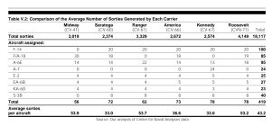

Yes CVs absolutely mogged CVNs in every aspect
Am I reading this wrong? CVNs have higher sortie rate, carry more aviation fuel and ordinance - thus can sustain longer and CVNs have lower times spent at depot and so more time available at sea. The overall total lifecycle cost may be higher, but CVNs seem more useful for their intended mission... what am I missing?

How ? If u have enough fuel for let say 3 months deployment then u dont need nuclear carriers.
What except endurance is beneficial for nuclear carriers ? Obv a 100k tonn nuclear will be more powerful as it will have more space to have fuel ammunition, parts and crew needes but more costly too

CVN can run at top speed until it breaks. CV will run out of fuel very quickly in the same conditions.
During combat, carriers move around a lot.
CVN can ditch its escorts and Usain Bolt away too, while making it easier for the escorts to survive.
