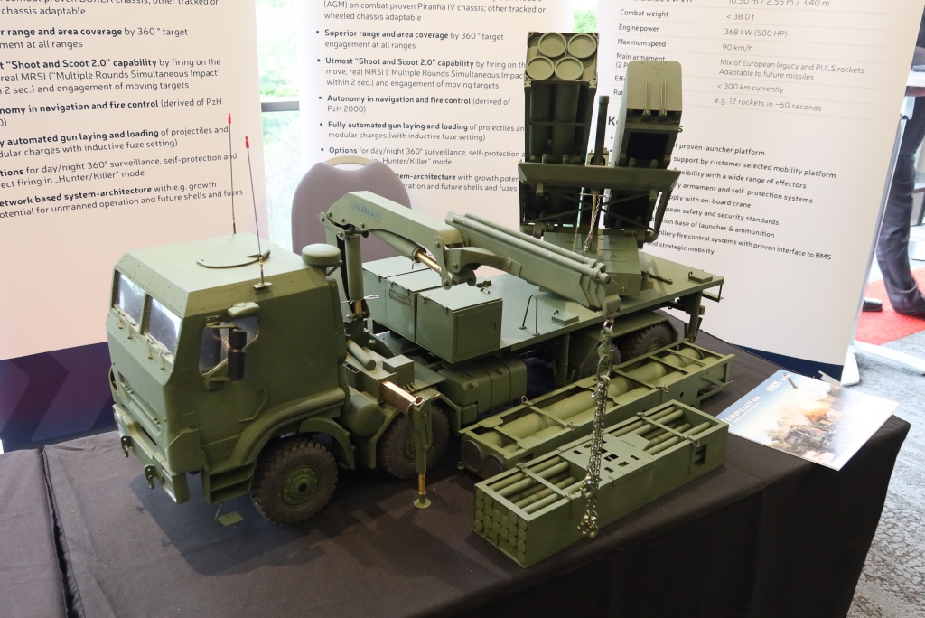

Ashwin, how's the reload efficiency like for different variants( calibre, launcher etc) of Pinaka ? Does PULS exceed it considerably?
Dont know about pinaka as its not multi caliber as of now.Ashwin, how's the reload efficiency like for different variants( calibre, launcher etc) of Pinaka ? Does PULS exceed it considerably?
Here's a picture of Pinaka's reloader cum replenishment vehicle, so if anything the reload efficiency of the Pinaka should be similar to PULS.Ashwin, how's the reload efficiency like for different variants( calibre, launcher etc) of Pinaka ? Does PULS exceed it considerably?
