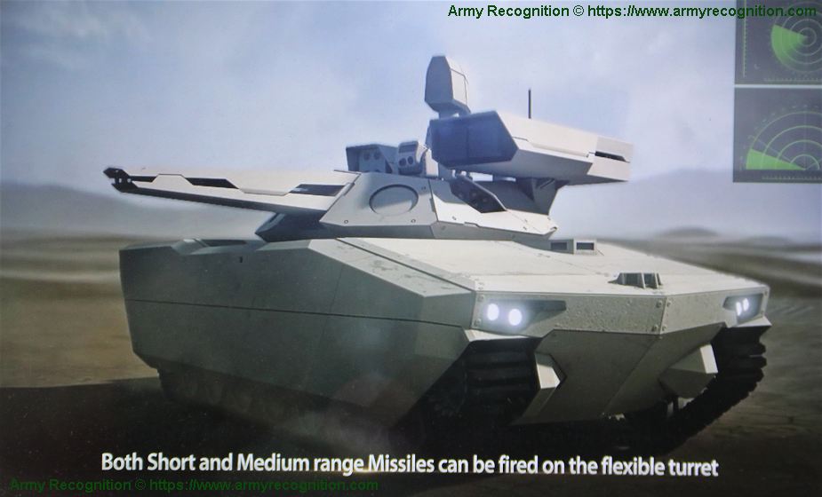

The Pantsir is a far, far superior system, particularly the Pantsir S1M and S2. But the Russians probably brought in an older variant, like the S1, and screwed up in some crucial requirements since it's outdated by now. Where they screwed up is not known, but they definitely screwed up. Of course, it doesn't help that Indian tenders take years to deliver, so stuff gets obsolete in the meantime, like how the S1 was not good enough to beat the Biho even though the Russians introduced the superior S1M and S2 at a later date.
The same thing happened with the MANPADS tender. The Russian Igla was inferior to its Western competitors, they simply got lucky that it met requirements by a hair. In the meantime, while the tender was running, the Russians introduced the superior Verba.
In both tenders, the Russians couldn't upgrade their offerings with superior systems.
The Koreans are introducing the Biho II pretty soon, which will be equivalent to the Pantsir S2 in capability, but on a far superior platform with an unmanned turret.
Biho II--
But, as it stands today, there's nothing better than the Pantsir S2.
Biho II--
