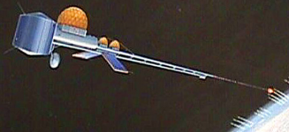

Martin-Marietta Zenith Star. Hydrogen fluoride laser (2.7e-6 m, 2700 nanometers near infrared), about 2 MW. 2 meter radius mirror. Maximum effective range about 300 km. 4.6 m diameter, 24.8 m long, 39,000 kg. At 300 km spot size is 0.25m radius, brightness is 10.4 MW/cm2 or 1.04 kW/cm2.

Zenith Star, as designed by Martin Marietta circa 1988, was a two-component vehicle. The aft spacecraft was the Alpha laser, which combusted fluorine with hydrogen to generate around 2 megawatts of laser light; the forward spacecraft would contain the optics (including a 4-meter diameter main mirror) and aiming system, turning the beam of light from the Alpha laser into a tightly focused "ray" aimed at the target 60 to 300 kilometers away.
Zenith Star was expected to fly in the mid 1990's, and, if successful, could have led to an operational space based laser around 2000. The collapse of the Soviet Union ended the threat of global thermonuclear war and ended support for the program.
Each of the two Zenith Star components was to be launched atop a Titan IV booster. Alternative concepts called for launching the spacecraft as a single unit; in order to do this, a heavy lift booster would be needed. The Zenith Star Launch System was thus proposed, a new vehicle built from existing components such as the five seven-segment boosters from the Titan IV and a larger diameter Titan core with 5 LR-87 engines. Additionally the complete Zenith Star could be launched by a Shuttle C; the Zenith Star diagrams here were created in large part from a Shuttle C/Zenith Star configuration. Details of the Zenith Star are, perhaps unsurprisingly, hard to come by. The spacecraft is 15 feet in diameter and 81.25 feet long. Weight for the single-launch vehicle is given as about 86,800 pounds.
On Nov. 24, 1987 during a visit to the Denver-based Martin Marietta Astronautics factory, President Reagan revealed for the first time the full dimensions and advanced status of the Zenith Star space-based laser demonstration project, a model of which is pictured on this page. Zenith Star is the Strategic Defense Initiative (SDI) continuation of the Defense Advanced Research Projects Agency space-based chemical laser program. The two major elements of Zenith Star are the LAMP mirror and the Alpha chemical laser, both of which elements have been demonstrated in laboratory experiments shown in the photographs.
