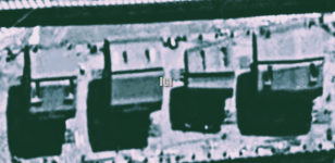

I had the same doubts but A.M Naik heavy engineering is known to be the facility where hull sections are made and then transported to SBC using a bargeNice find!
I don't think we can conclusively say yet if these are S-5 SSBN sections, but they certainly appear to be maritime vessel-related as they seem to be stored in position to be loaded on to a barge. Could be some unrelated industrial modules as well, though.

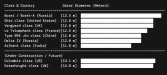

The size (as measured by you) is also interesting.
Also these are visibly cylindrical in shape, the second one looks like tail end section of a submarine
It was reported that construction of the 1st S5 sub started on December 2025.
Multiple hull rings can be spotted at hazira facility in historical imageryOf course, but L&T produces a whole lot of engineering goods at the Hazira plant in adjoining units. These pieces are likely to be submarine-related though, just can't say for sure. Wish they laid them on the side like this:

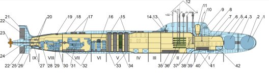

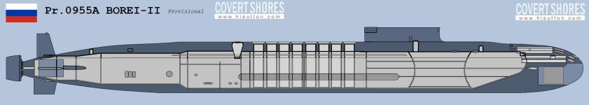

Only this submarine could carry the R39 (it was actually made to carry it) :JL2 looks a LOT like this thing indeed.
But, JL2 is 2 times lighter than R39 and achieves same/higher range (newer propellant compared to R39) and carries fewer MIRV warheads. Diameter and length is also lower.
So me thinks Chinese took aerodynamic inspiration from R39 but did most of the propellant/guidance work themselves.
Our K5 will weigh 2 times lower and be smaller in length than both and still be capable of reaching 8,000 km in light load configuration.
from 2023 - These rings start to appear from 2023, indicating fabrication of structures started years ago with completed modules being shipped now
