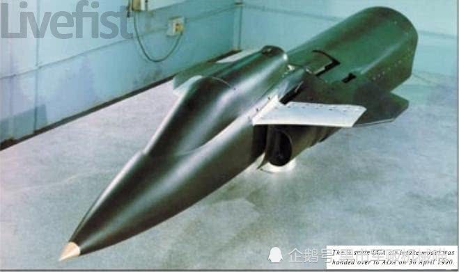

That's not how it works. It depends on the final design that was chosen for fabrication. In the PDP, you don't make just one design, you make multiple, that's why even AMCA's stand in the expo came with two different models, with two different wing designs.
LCA Mk1 also had multiple designs, you may have already seen the canard version.
This is LCA, with cropped cranked arrow with close-coupled canards.
And so is this.
0
The point is we do not know which design has been chosen for the final prototype construction.
The F-22 boys also made 10 different designs before zeroing in on what we see today.
