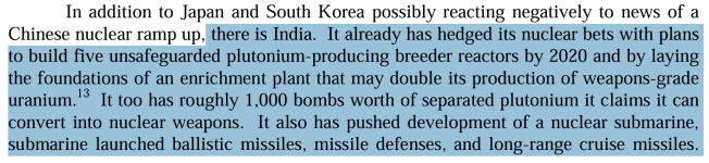

In 2012, American scientist Henry Sokolski, the then Executive Director of The Nonproliferation Policy Education Center testified before the U.S. Economic and Security Review Commission. The testimony was about China's nuclear weapons, but he did mention India in passing:
Source: https://www.npolicy.org/article_fil...gs-Uncertainties_and_Concerns_(TESTIMONY).pdf

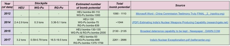

From the various reports so far we have the following:
As more PHWRs & FBRs become operational this bomb making potential will continue to climb. Of course, we are not going to push all fissile material we have into bombs. Having 2000+ bombs doesn't serve any purpose. We need to have around 400-450 at most.
