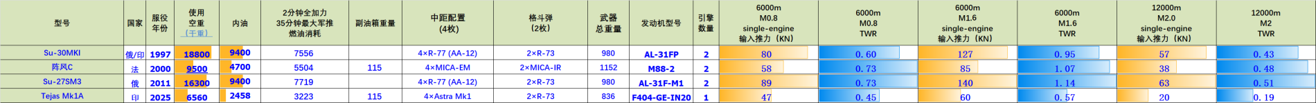

First of all, let’s establish the baseline scenario: to satisfy the operational profile of 2 minutes at full afterburner plus 35 minutes at maximum dry thrust for a round-trip combat patrol, the fuel fractions required are highly specific.
Su-30MKI, it must carry 7,600 kg of fuel. Combined with an ordnance package of 4x R-77s and 2x R-73s totaling 980 kg, and an empty weight of 18.8 tons, we look at the official performance charts. Under these exact parameters:

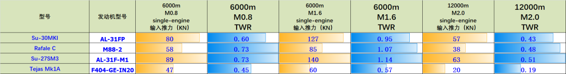

At 6,000 meters / Mach 0.8: The dual AL-31FP engines put out a combined 160 kN of thrust, yielding an overall thrust-to-weight ratio (TWR) of 0.60.
At 6,000 meters / Mach 1.5: The ram effect spikes the total dual-engine thrust to 240 kN, pushing the TWR to 0.90.
At 12,000 meters / Mach 2.0: The thin air drops total thrust to 114 kN, leaving a TWR of 0.43.
Rafale C under the exact same operational profile. It demands 5,500 kg of fuel. Since its internal fuel capacity maxes out at only 4,700 kg, it is forced to bolt on a 115 kg supersonic drop tank. Factor in an air-to-air loadout of 4x MICA and 2x Magic II missiles totaling 1,152 kg, and cross-reference the exact same flight regimes. The Rafale C’s dual-engine thrust figures clock in at 116 kN, 170 kN, and 76 kN, yielding TWRs of 0.73, 1.07, and 0.48, respectively.
Tejas Mk1A. To fulfill this mission, it requires 3,200 kg of fuel. Given its abysmal internal fuel capacity of just 2,458 kg, even assuming it can magically integrate the Rafale's 115 kg supersonic drop tank, you must add that 115 kg penalty. Slap on 4x Astra Mk1s and 2x R-73s totaling 836 kg, and check the charts. Under the identical three test conditions, its total thrust collapses to 47 kN, 60 kN, and 20 kN, resulting in pathetic TWRs of 0.45, 0.57, and 0.19.
Keep in mind, these raw numbers don't even factor in Sukhoi’s massive aerodynamic advantages—such as its Blended Wing-Body (BWB) lift generation and thrust-vectoring superiority—nor do they account for the severe parasitic drag and aerodynamic degradation inflicted on the Rafale and Tejas by forcing them to haul external drop tanks just to stay airborne.

If you look at a single-seat Su-27SM3 paired with the AL-31FM1 (which shifts the entire thrust curve upward by 5% to 10%), the aircraft's empty weight drops to just 16.X tons. Under the exact same mission profiles, its estimated TWRs rocket to 0.73, 1.06, and 0.51, completely obliterating the Rafale across the entire envelope.

Apologies, I spoke too soon on the last post. I misread the graph and mistook the AL-31F's thrust at Mach 1.6 for Mach 1.5, which unfortunately lowballed the Su-30MKI's actual performance. But hey, even with my data accidentally dialed down, it still completely ran circles over your little paper jet.

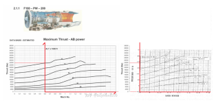

The F110 see a 25% loss in thrust when it's installed in the F-15E. And it's around 20% for F-16 with F100. That's why you get 22000 lbs for F-15E and 24000 lbs for F-16.
When the F-15E starts its engines and goes full burner, the pressure loss in the inlet is 5%, which translates into a direct thrust loss of 10%. Once you take away bleed air for cooling and mechanical energy for electricity generation and other losses, the overall thrust loss is at 25%. So 29500 lbs becomes 22000 lbs at the exhaust.
Here: Mig-29.
Your pet jet here's delivering 13600 kgf of installed thrust versus it's uninstalled thrust of 16600 kgf. That's almost 20% loss in thrust.

A 25% installed thrust loss'—you really just love pulling numbers straight out of thin air, don't you?
Like I said before,
every single time you post, you just invent a brand-new lie just to cover up your previous one.
At this point, it’s a statistical nightmare trying to find even two correct sentences in that entire mountain of garbage you just typed
As for exactly how much power the RD-33 loses inside the MiG-29's intake—this exact chart spells it out in black and white. The dashed lines represent the uninstalled thrust, and I’ve highlighted the low-altitude ones in blue.
And for your further education, this is the exact comparison chart showing the uninstalled thrust of the AL-31F versus the actual installed thrust curves of the Su-27.
To claim this somehow reaches a 25% loss from F110-GE-129 is downright delusional.
Just to be absolutely sure, I’m going to keep pressing you on this: what exactly does that 22,000 lbs in your picture equate to in metric tons of thrust? Did GE explicitly leave a footnote telling you that this number already accounts for your imaginary '25% installed loss' or whatever nonsense you're preaching?
Oh, so according to your twisted logic, the gap between the Su-27's installed thrust and test-bench thrust is a mere 500 kg, but somehow the American F-15E suffers a catastrophic 25% loss? Are you seriously trying to tell us that American engineering is that incompetent?
