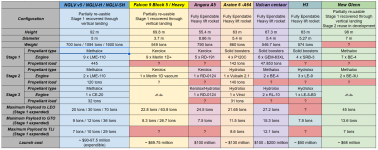

This is how the NGLV V4 compared with other contemporary heavy lift rockets from around the world:
Not bad at all.

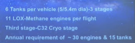

Update on NGLV's developmental work:
The NS3 stage shown below is a Methalox upper stage:
ISRO has previously proposed a LM40 methaox upper stage for the NGLV. But this stage probably wasn't sanctioned to be built. The sanctioned NGLV will borrow the LVM3's C32 stage for 1st 3rd stage.
