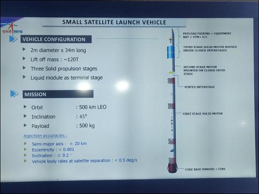

On Small Satellite launch Vehicle :

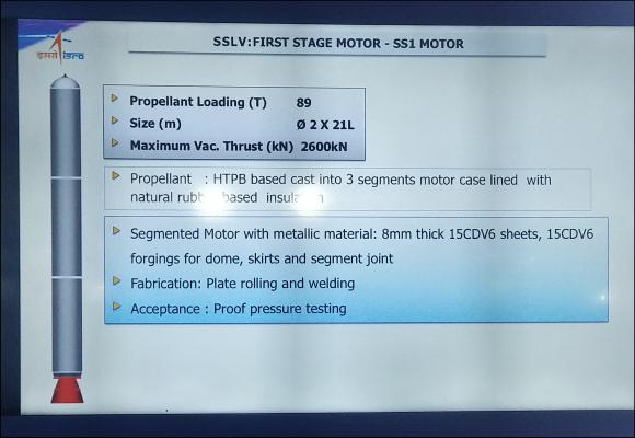

SSLV-D1: Design of all vehicle systems is completed and hardware realisation is progressing in fast track mode. The activities towards static test of first stage solid motor (SS1) are progressing. Acceptance testing of second stage (SS2) flight motor case completed. Third stage (SS3) motor is under propellant processing.​

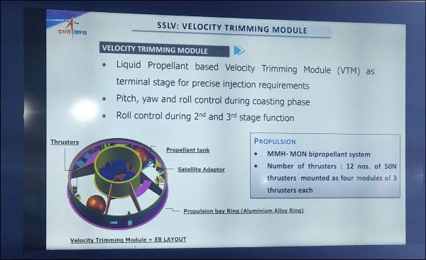

Vibration test of propellant tank for Velocity Trimming Module were completed. 50N thrusters & valves were realised. Assembly and integration scheme and flight measurement plans were finalised.​
