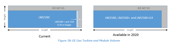

The scale & scope of modification will vary based on the ship. Trieste for example is already made for MT30 so just changing the transmission would be more straightforward compared to JC-1 or Mistral which may have to undergo a greater degree of redesign internally (MT30 enclosure is going to be physically larger than LM2500, while Mistral will have to find a way to rearrange the layout from 3 x diesel engines to a single, or two, MT30s. There might be some CoG/CoM changes that have to be accounted for to recertify the hull.

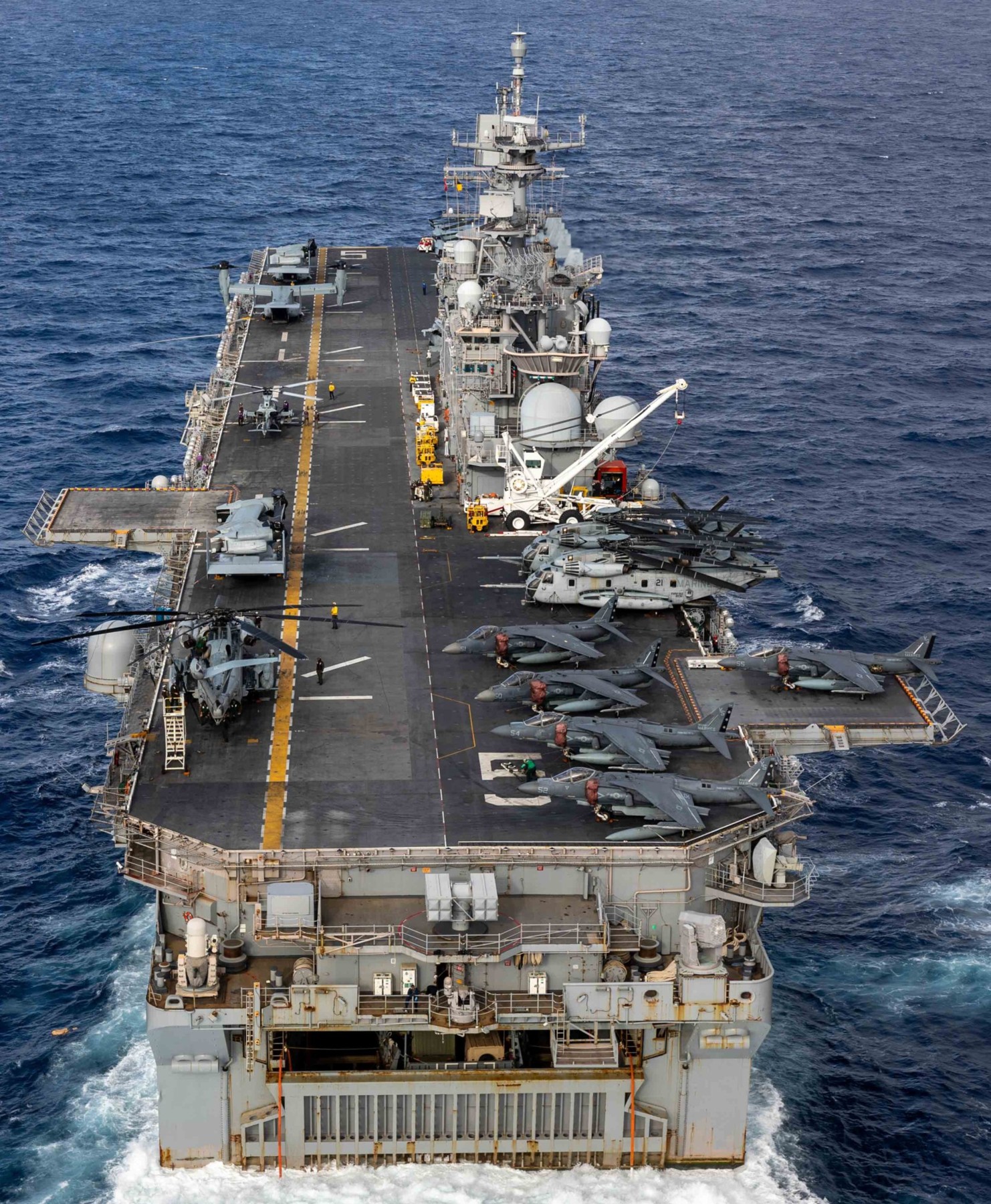

It's possible we might end up requiring strengthened, outboard elevators (like on US LHDs):
Again, it's nothing undoable. But will require a revisit to the drawing board for sure. So no ready-made solution, unlike Turkey or Australia buying the Juan Carlos as-is.

On the propulsion rearrangement, I think it's a non-issue. This is not a frigate or destroyer where space is extremely tight. It should be easy to change and rearrange the propulsion quite easily.
