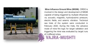

Mine Influence Ground Mine (MIGM) : DRDO is involved in the design and development of MIGM capable of being triggered by multiple influences viz. acoustic, magnetic, hydrodynamic pressure, electric fields, and seismic vibration. Technical sea trials of the system were conducted in February 2020. During the trials, the advance mode of mine fire logic for target validation and triggering the mine was evaluated by target runs of 3 different ships.

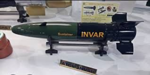

I couldn't find any news related to the type of ATGM that the Indian Army ordered, I was expecting a NAG 2 order, but I got a report regarding the Invar missile for the T90.
Isn't that that a Gun launched ATGM? Why are they going for that instead of NAG 2?
NAG is a tank-launched missile system; if we want a similar type of tank-barrel-launched missile system, we have to go with the SAMHO missile, which is not fully certified.
Invar is also tank launched though. It is launched through Gun barrel of a tank. It is also laser guided instead of using a seeker irrc.
SAMHO/CLGM has completely gone off the radar, no?
The missile was supposed to equip the Arjun Mk1A as a gun-launched anti-armour weapon with over 5 km range. It was the preferred choice over the Israeli LAHAT which was trialed in India some years back.
There was even a tripod mounted infantry variant but that too seems to be going nowhere.
Its likely only Arjun specific version so far, hence obvious less priority as a project. Its test was 2 years ago probably, maybe 3 but given small batch size for a small batch of active Arjuns not a surprise to be seen nowhere at present. Right now even the regular priority projects are delayed due to emergency procurement product support. You can see how tests keep getting rescheduled. Due to emergency buying, Invar gets order as T90s are more nos available, frontline tank.
More concern should be with what is the status with the existing ordered Arjun batch that got into the powerpack issue with MTU. Once that batch is inducted there would be scope for CLGM for tests, clearance & finally small LSP. But it is 10+ years away probably.
