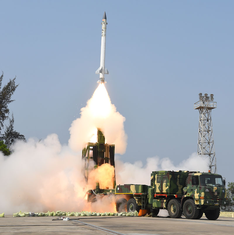

This has been discussed multiple times before as well. You cannot compare the volume of 2 different missiles and give a judgement on its range. Range is dependent on multiple variables but most importantly on what is the user requirement. This is not a strategic missile like Agni-5 that you need to understate its range for geopolitical reasons either. There is no reason to doubt the numbers given by the scientists that made the missile. Akash-NG is meant to be more maneuverable missile. It is going to go against highly maneuverable supersonic targets. That means, Akash-NG might have more solid fuel than Barak-8 but Akash_NG is going to burn that fuel much faster to be more effective in its end stage. Compare the launchers of barak8 vs akashNG. Barak8 has 8 tubes with vertical launch i.e. the missile is meant to follow a ballistic trajectory and is NOT very maneuverable in it end stage. AkashNG has slewable launcher with 6 tubes i.e it will be launched head on in the intended direction, more maneuverable in its end stage.Old DRDO Video from Aero India or some DefExpo.

Barak8 is a less maneuverable missile than AkashNG but Barak8 has been successfully tested(from ships) against brahmos repeatedly. This leads me to believe that AkashNG will do better than Barak8 in intercepting a supersonic missile like brahmos. This is just my opinion.Explicitly mentioned as "subsonic cruise missile".
