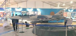

Hmm...Marut itself means Vayu: The Wind God. Lord Hanuman, as we all know, is son of Marut/Vayu so known as Maruti/Pawan Putra. Now HLTF-42 portrays Lord Hanuman in its vertical tail. The silent meaning is obvious.
Interestingly, I typed this in the morning:
It is Marut with an uglier cockpit and beautiful newer set of wings.

Fuselage is elliptical and fat..
Thought range should be even higher..
By hard points , it ll exceed Tejas mk2
and if it's mk1 nose, radar TRM modules should be same as Mk2 or higher.. That explainS IRST .
All the , over designing of Mk1 is optimized, HLFT is a level higher than Mk1 in almost all the specs.
With low set wings, conformal fuel tanks also possible if necessary..
Will be interesting to know about cockpit.. Whether they ll install Mk1 Or Mk2 layout.
Engine GE 414 ?
Cause length also higher than mk2.
