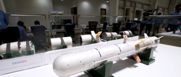

ULPGM V2:
Length: 890 mm
Diameter: 100 mm
Wingspan: 200 mm
Weight: 8.5 kg
Range: 4 km (when released from 750 m) - 6 km (when released from 2 km)
Guidance: Uncooled IIR seeker
Accuracy: 100 m
Communication: S-band 2-way datalink
Propulsion: Dual thrust solid rocket motor with thrust vectoring, smokeless propellant.
Warhead: 2 kg
Warhead types: Pre-fragmented (Anti-personnel) / Explosively formed penetrator (Anti-tank) / PCB (Bunker buster up to 6-inches of RCC)
Some photos of the V2:
BDL has received a Rs 105 crore (~USD 12.5 million) LSP order to produce the ULPGM V2 for the Army. Total quantity of these munitions to be supplied is 220. Unit price come out around Rs 47.7 lakh (~USD 56-57 k). Adani Defence will also produce these missiles. Prices should climb down in the subsequent orders.

ULPGM V2:
Length: 890 mm
Diameter: 100 mm
Wingspan: 200 mm
Weight: 8.5 kg
Accuracy: 100 m
Warhead: 2 kg
