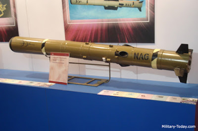

(E.1) NAG:
NAG missile
Latest iteration of NAMICA vehicle (source: trishul-trident.blogspot.in/)
A 2010 video of NAG missile tests. It very clearly shows the lofted profile of the missile and it hitting the top part of the tank target
  • The most well-known anti-tank missile under development by DRDO. It is a 3rdGeneration, Fire-and-Forget missile, top-attack missile which uses Imaging Infrared (IIR) seeker. The missile works in Lock-On-Before-Launch (LOBL) mode.
  • NAG is a heavy missile weighing in excess of 40 kg and fired from a dedicated platform known as NAMICA based on BMP-2.
  • It has no prior equivalence in the Indian Army and when inducted, it will represent addition of new anti-tank capability. In fact, there are only few missiles in the this class.
  • The F&F guidance system means the launch vehicle can move out after firing the missile which leads to better survivability. Further, the missile is ‘top-attack’ – which means it attacks the top section of a tank’s turret, a place with weakest armour ensuring effective kill.
  • As per the latest news report, the missile has successfully undergone development trials in second week of June with improved target seeker; the missile demonstrated ability to hit target at 4 km range under highest daytime temperature (11am to 3pm). It is likely that missile will now enter User-Trials.
  • The Recce & Support (R&S) battalions of the army are likely to be the first candidate for these missiles.

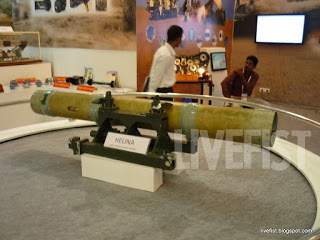

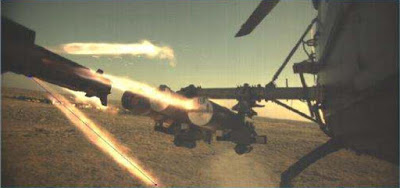

(E.2) HELINA (Helicopter Launcher NAG):
HELINA being fired from WSI-Dhruv/Rudra helicopter (source: internet)
HELINA missile in its launcher tube
Close-up of HELINA missile leaving WSI-Dhruv/Rudra. The exhausts from mid-body mounted booster rocket of the missile are visible (image source: internet)
Source: TRISHUL
  • HELINA is the helicopter launched version of NAG missile.
  • It is being developed for use abroad the WSI-Dhruv/Rudra and Light Combat Helicopter.
  • HELINA is an advanced, third generation missile which has 7km range, Lock-on-After-Launch (LOAL) capability and 2-way RF command-and-video data link.
  • The LOAL capability allows the helicopter to fire the missile in general area of the target and then use missile’s seeker to lock-on when the target becomes clear. As the missile gets closer to the target area, the missile seeker pics up the target(s). The 2-way RF command-and-video data link transfers the seeker video to gunner’s cockpit. The gunner can then place the target tracker on a specific target. Post this, the gunner can either guide the missile himself to the target or missile does so autonomously.
  • The 2-way RF video-and-command link was achieved in 2011. The missile achieved 7 km range from ground-launch platform in 2013.
  • In June 2014, the missile was fired from Rudra helicopter and achieved 7 km range from airborne platform.
  • Again in mid-2015, ‘hot fire’ trial of HELINA was done for 7 km range. Of three missiles fired, 2 managed to hit the target.
  • The missile was to be tested in September 2016 with a new Imaging Infra-Red (IIR) Seeker with more sensitive Focal Plane Array (FPA); earlier version had 128×128 FPA while September 2016 test will have missile with 640X512 FPA.
  • Considering that army is keen to acquire an interim ATGM for already inducted Rudra helicopters and for those to be shortly inducted, it seems there is some development work pending on the missile
  • There is unverified report that HELINA is under-going redesign to ensure the exhaust from mid-body mounted booster don’t radiate outwards. Instead, the exhaust will now pass through the body of the missile and exit from the rear.

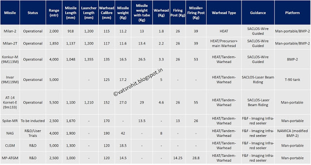

(F) Summary of Missile & Technical Data
The table below summarizes the range, weight, guidance and other dimensions of the missiles already operational, to be inducted or under R&D phase.

(E.1) NAG:
NAG missile
