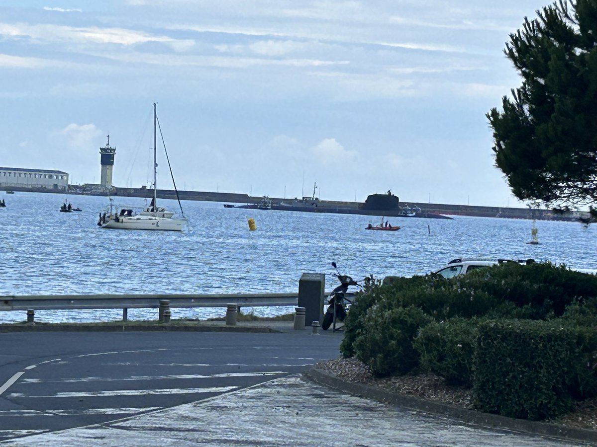

2/ #subs #SNA_Tourville (Suffren SSN class n°3)
Third unit of the Suffren class, the Tourville nuclear attack submarine begins sea trials
(...) On 12 July, the Tourville made its first sea voyage, marking the start of the test campaign prior to its delivery to the DGA and then to the French Navy. Like its two predecessors, the SNA Suffren and the SNA Duguay-Trouin, the Tourville crossed the Cherbourg roadstead to venture into the Bay of Becquet (…). This is where it will undergo its first periscope immersion in order to validate its watertightness, stability and the operation of its main equipment. Its exact mass will also be determined.
If everything is normal, the Tourville will then go on to undergo 'dynamic' trials in the open sea, supervised by the DGA and the Military Applications Division [DAM] of the French Atomic Energy and Renewable Energies Commission [CEA]. During this period, and until delivery, it will remain the property of Naval Group and TechnicAtome
